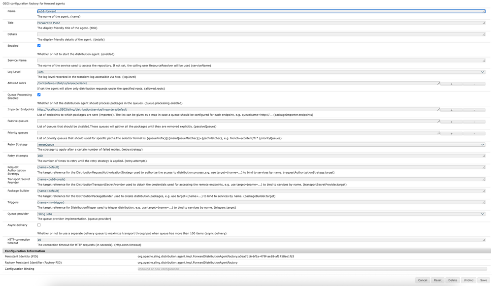

I have a use case that is resource-intensive, and I cannot run it on the author instance. Instead, I want to execute it on a single publisher, save the output as a DAM file, and then sync it across other publishers.
To achieve this, I decided to use Sling Content Distribution (forward distribution). Here’s what I’ve done so far:

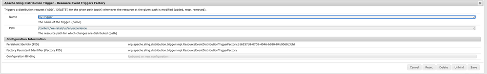

  • Set up a forward distribution agent and a trigger on the source publisher.

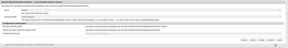

  • Configured a local distribution package importer on the target instance.

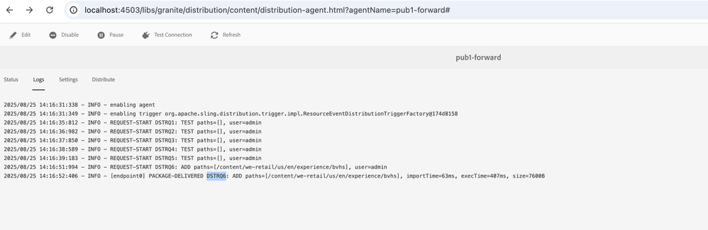

From the source publisher side, the connection test is successful, and when I try distributing content from the console it reports “package delivered.” However, I don’t see any updates reflected in the target instance.
One observation: I can see the POST calls in the target instance’s request logs, but the actual content updates aren’t showing up.
Has anyone faced a similar issue or know what I might be missing in this setup?

naveen_kvs
August 25, 2025
Hi @vishalka5,
Thanks for your response and suggestions.
My initial config is Local Package importer. Now, I have changed it to filevault, still the same.
  • Check /system/console/slingdistribution on target for queue errors. - I cannot find it and i do not see any errors in error.log
Also i have given admin creds in the forward agent so do not think it might be an access issue.
