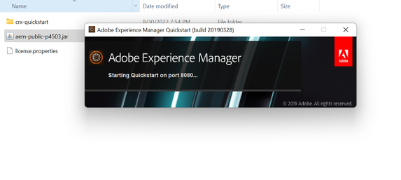

I am facing issue on  public instant .I try run port 4503 while getting port 8080.can you pls help me on this issue. Please check below picture.

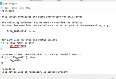

In crx-quickstart go to -> bin -> start.bat .Edit the file in Notepad.
Check the CQ_PORT value here and change it if required.
Mostly the issue is occurring because the Port is already being used.

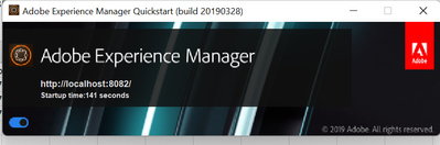

I have done what have you suggested things but still facing same issue .i have changed port also pls look below pictures. Pls help me on this.

@chandrika123 First thing, your name of JAR is wrong. It is not public ; it should be publish. This happens when you are running the quickstart and the port is already occupied. So if I go by the image , you are trying to run a jar for 4503 port. But that port might be engaged and hence it is taking any available port and running the same. If you use CMD commands to run your jar , this can be avoided most of the times. Also as mentioned in the above reply , you can find the port using netstat commands and kill it.
