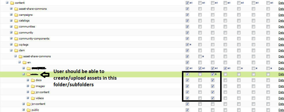

in this I have created a new user group with below like permissions for all parent folders:
What my basic requirement is that I want the users (belonging to this user group) to only have read and create permission in my project's folder path (Let say: content/dam/ASC/en/MyFolder)
To do this I have given read and create permission to that folder paths as shown below, but I am not able to see the Create button in Assets folder path to be able to upload the assets in the AEM Assets screen.

That's unfortunate, but not really unexpected.
If I see it correctly, the create button explicitly requests MODIFY permissions on that folder. Because modify also contains the "add children" permission.
That means while the underlying JCR permissions would allow a very fine-grained permission control, the UI does not expose it in that granularity and modelling at this level gets nearly impossible.
I would provide the group the modify permission and instead disallow write permission on the metadata nodes (using wildcard ACLs). That should result in the same outcome.

Hello niks1020,
Jorg is correct. You need to add 'Modify' permission also.
I tried adding 'Modify' permission along with Read and Create permission to the group and I could see 'Create'
button visible in <host:port>/assets.html/content/dam but without Modify permission create button is not visible.
Give this a try!
