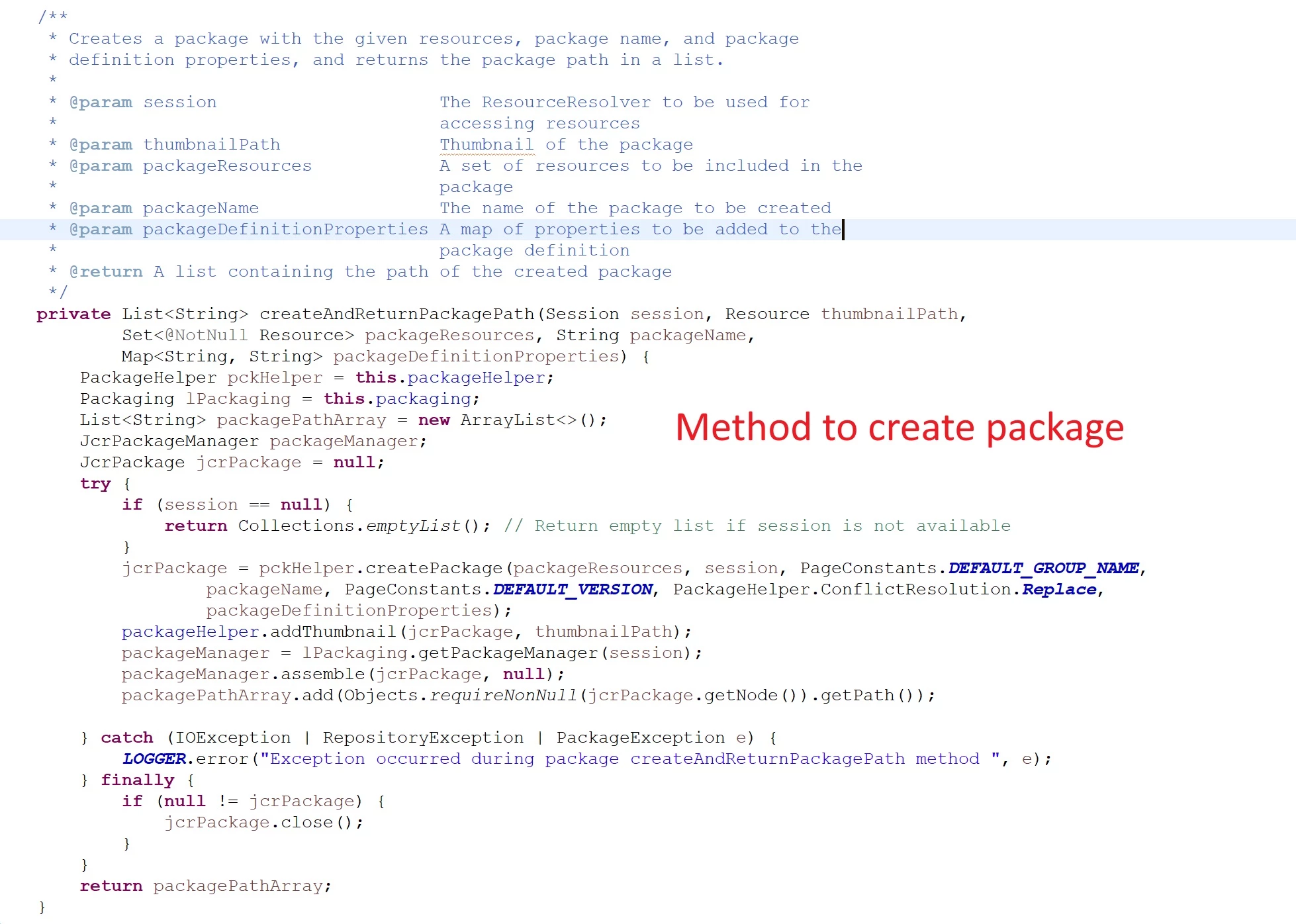

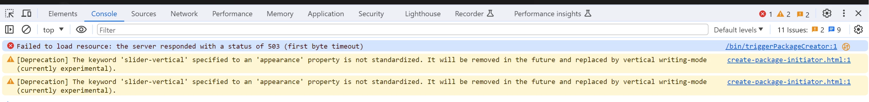

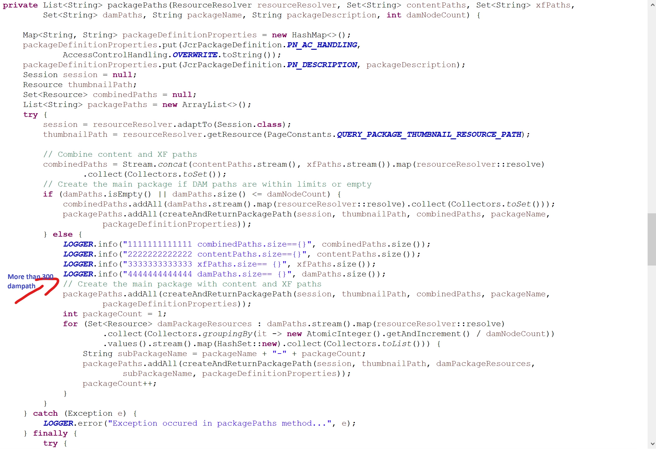

Dear Developers/Architects,
 I was trying to create packages programatically in AEM, it fetchs given page's  path and page's reffrences like xf paths and dampaths(more than 1500 dampaths), i combined content path and xf path in seprate package(package-0). when comes to dampath i splited the dampath in to 300 dampath/package and tried to create  packages(package-1,package-2 & viceversa..).  when i ran this code in my local aem instance, i was able to create spilt of packages(combined (xf & content paths) package and split of dampath packages) without any issues. when i deploy the code on AEMasCS, im getting gateway timeout issue. Kindly let us know your suggestion on this...
java code if the dampath more than 300

Hi @Kamal_Kishor , as per adobe recomendation, we should not create large set of packages, is there any limits Adobe have given as i dont see the package size limit on the link you sent., Also the user have full access rights to /etc/packages folder.

Hi @yashp0808 ,thanks for your response, the gateway timeout issue happened on the line below higlighted in the screenshot attached, where createPackage method. so saving the session will not work in the finally block.

yes @Kamal_Kishor , in my local instance its 280MB. same  was not working in AEMascs. In error logs, im not seeing gateway timeout,when i see browser console im getting gateway timeout for the servlet call. logs, i can see it stopped  executing on the line packagehelper.createpackage method.

when i ran the code, im getting below error.
9 *INFO* [[0:0:0:0:0:0:0:1] [1706079271697] POST /bin/triggerPackageCreator HTTP/1.1] org.apache.jackrabbit.vault.packaging.PackagingService JcrPackageManager acquired w/o service! Alternate package roots will not be respected.
java.lang.IllegalStateException: null
Hi @Raja_Reddy , Please find the java file.
import java.io.IOException;
import java.io.PrintWriter;
import java.util.ArrayList;
import java.util.Arrays;
import java.util.Collections;
import java.util.HashMap;
import java.util.HashSet;
import java.util.Iterator;
import java.util.List;
import java.util.Map;
import java.util.Objects;
import java.util.Set;
import java.util.concurrent.atomic.AtomicInteger;
import java.util.stream.Collectors;
import java.util.stream.Stream;
import javax.jcr.RepositoryException;
import javax.jcr.Session;
import javax.servlet.Servlet;
import org.apache.commons.lang3.StringUtils;
import org.apache.jackrabbit.vault.fs.io.AccessControlHandling;
import org.apache.jackrabbit.vault.packaging.JcrPackage;
import org.apache.jackrabbit.vault.packaging.JcrPackageDefinition;
import org.apache.jackrabbit.vault.packaging.JcrPackageManager;
import org.apache.jackrabbit.vault.packaging.PackageException;
import org.apache.jackrabbit.vault.packaging.Packaging;
import org.apache.sling.api.SlingHttpServletRequest;
import org.apache.sling.api.SlingHttpServletResponse;
import org.apache.sling.api.resource.Resource;
import org.apache.sling.api.resource.ResourceResolver;
import org.apache.sling.api.resource.ResourceResolverFactory;
import org.apache.sling.api.servlets.SlingAllMethodsServlet;
import org.apache.sling.servlets.post.JSONResponse;
import org.jetbrains.annotations.NotNull;
import org.osgi.service.component.annotations.Component;
import org.osgi.service.component.annotations.Reference;
import org.slf4j.Logger;
import org.slf4j.LoggerFactory;
import com.adobe.acs.commons.packaging.PackageHelper;
import com.adobe.granite.rest.Constants;
import com.day.cq.wcm.api.Page;
import com.day.cq.wcm.api.PageManager;
import com.google.gson.Gson;
import com.google.gson.JsonObject;
 * @author Raja
 *         <p>
 *         Servlet that facilitates the creation of content packages. This
 *         servlet allows clients to create content packages by providing
 *         relevant details. It extends the SlingAllMethodsServlet, allowing it
 *         to handle various HTTP methods, primarily POST.
@Component(service = { Servlet.class }, property = { "sling.servlet.paths=" + "/bin/triggerPackageCreator",
        "sling.servlet.methods=POST" })
public class PackageCreatorServlet extends SlingAllMethodsServlet {
    private static final long serialVersionUID = 1L;
    // Logger instance for this class
    private static final Logger LOGGER = LoggerFactory.getLogger(PackageCreatorServlet.class);
    // Constants for package creation messages, default values and resource paths
    // List to store paths of child pages for the package
    private final List<String> childPagePathList = new ArrayList<>();
    // Reference to a helper for package creation
    @Reference
    private transient PackageHelper packageHelper;
    // Reference to the packaging service
    @Reference
    private transient Packaging packaging;
    @Reference
    private ResourceResolverFactory resourceResolverFactory;
     * Handles the POST request to create a content package. Processes the input
     * parameters, interacts with the packaging service, and returns a JSON
     * response.
     * @param request  The Sling HTTP request object.

    private List<String> packagePaths(ResourceResolver resourceResolver, Set<String> contentPaths, Set<String> xfPaths,
            Set<String> damPaths, String packageName, String packageDescription, int damNodeCount) {
        Map<String, String> packageDefinitionProperties = new HashMap<>();
        packageDefinitionProperties.put(JcrPackageDefinition.PN_AC_HANDLING,
                AccessControlHandling.OVERWRITE.toString());
        packageDefinitionProperties.put(JcrPackageDefinition.PN_DESCRIPTION, packageDescription);
        Session session = null;
        ResourceResolver resolver = null;
        Resource thumbnailPath;
        Set<Resource> combinedPaths = null;
        List<String> packagePaths = new ArrayList<>();
        try {
            thumbnailPath = resourceResolver.getResource(PageConstants.QUERY_PACKAGE_THUMBNAIL_RESOURCE_PATH);
            final Map<String, Object> authInfo = Collections.singletonMap(ResourceResolverFactory.SUBSERVICE,
                    "demoSystemUser");
            resolver = resourceResolverFactory.getServiceResourceResolver(authInfo);
            session = resolver.adaptTo(Session.class);
            // Combine content and XF paths
            combinedPaths = Stream.concat(contentPaths.stream(), xfPaths.stream()).map(resourceResolver::resolve)
                    .collect(Collectors.toSet());
            // Create the main package if DAM paths are within limits or empty
            if (damPaths.isEmpty() || damPaths.size() <= damNodeCount) {
                combinedPaths.addAll(damPaths.stream().map(resourceResolver::resolve).collect(Collectors.toSet()));
                packagePaths.addAll(createAndReturnPackagePath(session, thumbnailPath, combinedPaths, packageName,
                        packageDefinitionProperties));
            } else {
                LOGGER.info("1111111111111 QAQAQA#### combinedPaths.size=={}", combinedPaths.size());
                LOGGER.info("2222222222222 QAQAQA#### contentPaths.size=={}", contentPaths.size());
                LOGGER.info("3333333333333 QAQAQA#### xfPaths.size== {}", xfPaths.size());
                LOGGER.info("4444444444444 QAQAQA#### damPaths.size== {}", damPaths.size());
                // Create the main package with content and XF paths
                int packageCount = 1;
                for (Set<Resource> damPackageResources : damPaths.stream().map(resourceResolver::resolve)
                        .collect(Collectors.groupingBy(it -> new AtomicInteger().getAndIncrement() / damNodeCount))
                        .values().stream().map(HashSet::new).collect(Collectors.toList())) {
                    String subPackageName = packageName + "-" + packageCount;
                    packagePaths.addAll(createAndReturnPackagePath(session, thumbnailPath, damPackageResources,
                            subPackageName, packageDefinitionProperties));
                    packageCount++;
        } catch (Exception e) {
            LOGGER.error("Exception occured in packagePaths method...", e);
        } finally {
            try {
                // Close the Session if it's not null
                if (null != session) {
                    session.logout(); // Or the appropriate closing method
                LOGGER.error("Error closing Session: ", e);
            } finally {
                try {
                    // Close the ResourceResolver if it's not null
                    if (null != resourceResolver) {
                        resourceResolver.close();
                    if (null != resolver) {
                        resolver.close();
                    LOGGER.error("Error closing ResourceResolver: ", e);
        LOGGER.info("combinedPaths.size=={}", combinedPaths.size());
        LOGGER.info("contentPaths.size=={}", contentPaths.size());
        LOGGER.info("xfPaths.size== {}", xfPaths.size());
        LOGGER.info("damPaths.size== {}", damPaths.size());
        return packagePaths;

    private List<String> createAndReturnPackagePath(Session session, Resource thumbnailPath,
            Set<@NotNull Resource> packageResources, String packageName,
            Map<String, String> packageDefinitionProperties) {
        PackageHelper pckHelper = this.packageHelper;
        Packaging lPackaging = this.packaging;
        List<String> packagePathArray = new ArrayList<>();
        JcrPackageManager packageManager;
        JcrPackage jcrPackage = null;
        try {
            if (session == null) {
                return Collections.emptyList(); // Return empty list if session is not available
            jcrPackage = pckHelper.createPackage(packageResources, session, PageConstants.DEFAULT_GROUP_NAME,
                    packageName, PageConstants.DEFAULT_VERSION, PackageHelper.ConflictResolution.Replace,
                    packageDefinitionProperties);
            packageHelper.addThumbnail(jcrPackage, thumbnailPath);
            packageManager = lPackaging.getPackageManager(session);
            packageManager.assemble(jcrPackage, null);
            packagePathArray.add(Objects.requireNonNull(jcrPackage.getNode()).getPath());
        } catch (IOException | RepositoryException | PackageException e) {
            LOGGER.error("Exception occurred during package createAndReturnPackagePath method ", e);
        } finally {
            if (null != jcrPackage) {
                jcrPackage.close();
        return packagePathArray;
