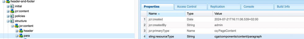

In this use case, I was including my resource in html like below,
<div class=“para”>
                <sly data-sly-resource="${@path=‘para’, resourceType=‘abc/components/content/paragraph'}"/>
            </div>
But if I move this inclusion to template structure, the issue is fixed.
so, as per my understanding, we should follow the second way(though first approach also rendering components properly) to include component to avoid further complications.
