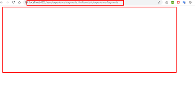

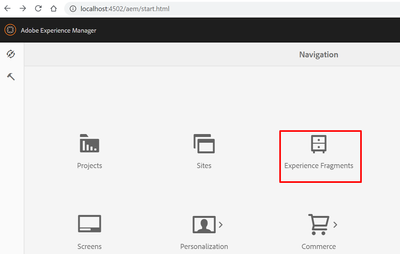

I want to create experience fragment in AEM 6.5 (No Service Pack) ,but when I try to do so , I am redirected to blank page and no default templates are shown in order to create ef.

Can you try this on a new instance without custom code? Also, Check if you are starting instance with "samplecontent" as nosamplecontent will not have any predefined templates to create XF.
Ideally, you should see a Create button at the top right.

Can you please confirm s this a vanilla 6.5 or a 6.5 with your custom code. Also, are you starting it with nosamplecontent runmode or not
@Jaideep_Brar , tried with new instance and found its working . Thanks a lot.
