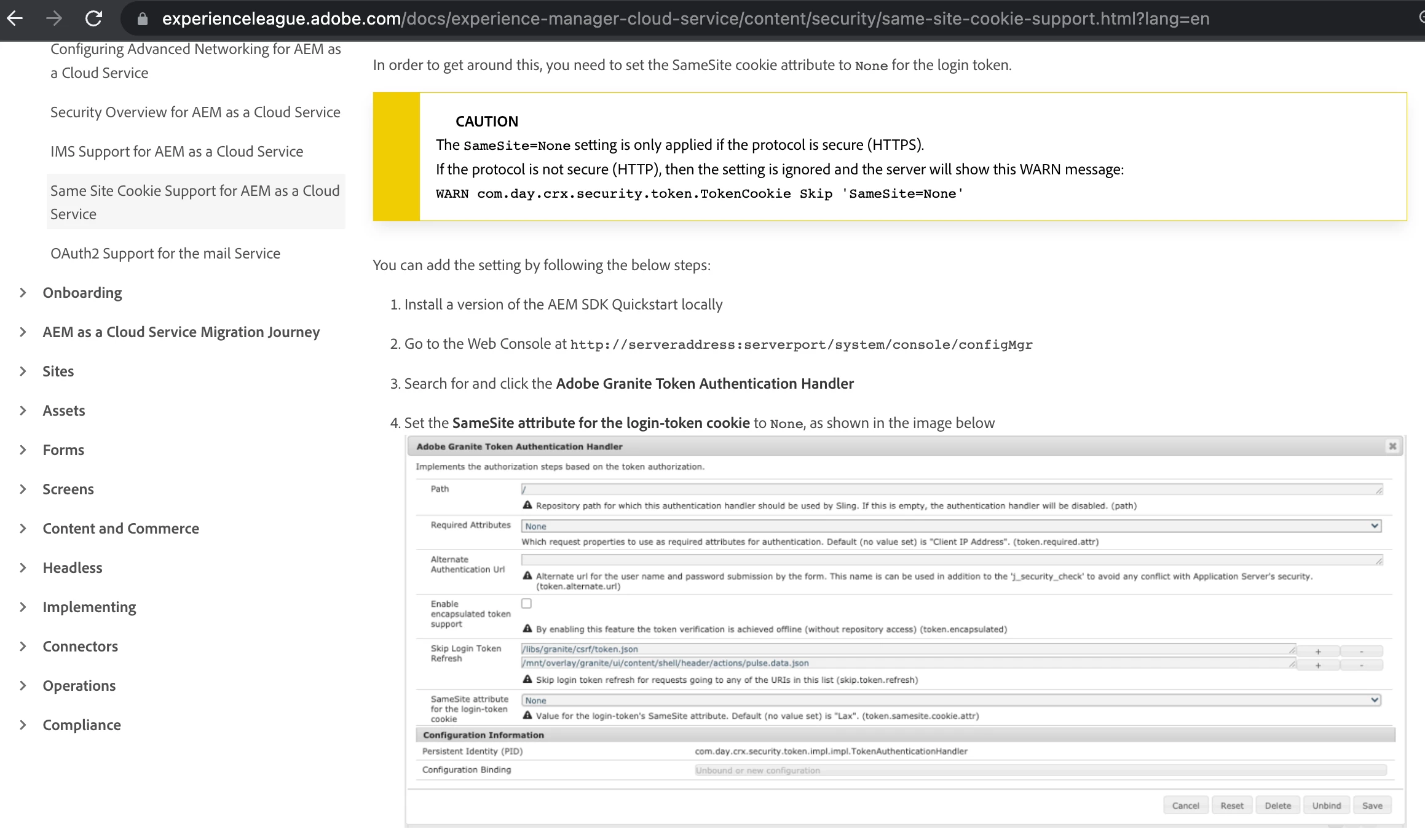

Hi @baoyu_li - There is no specific mention of AEMaaCS not supporting Encapsulate token.
There is also a reference of the Adobe Granite Token Authentication Handler configuration in one of the AEMaaCS documentation pages with "Enable Encapsulation token Support" flag. So, I believe it is pretty much safe to assume that the feature is supported.
Ref - https://experienceleague.adobe.com/docs/experience-manager-cloud-service/content/security/same-site-cookie-support.html?lang=en

I did not checked in the details but do you have local aem sdk, if you can check Adobe Granite Token Authentication Handler configuration ?
  1. Look for an entry called Adobe Granite Token Authentication Handler and click it.
  2. In the following window, tick the Enable encapsulated token support box and press Save.
I did not find any documentation around CUG and encapsulated token in AEMaaCS.
