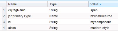

To change the default div tags to something else , use cq:htmlTag nodes in your components. This lets you modify the tag , classes and id associated with the decorator tag.
Add id property [type:String] with id to be added to the enclosing tag
// Link:- http://www.codermag.net/2016/02/remove-component-wrapper-divs-in-cqaem.html
[img]https://1.bp.blogspot.com/-7PniUsdjAiA/VtWYxtivtDI/AAAAAAAAAW4/PRoAPnkJMy0/s1600/cq_nodecoration%2Be... [/img]
this will render the component as:-
<span id="mycomponent" class="modern-style">
</span>
I hope this would help you.
