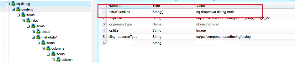

    4. Go to your component node and add another data-* attribute value as below. This value can be anything
    5. Now I copied the dropdownshowhide.js JS to my component to modify it. I created a clientlib and added it as extraclientlib to my component.

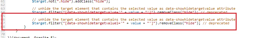

    6. Now in the JS I added an additional line to make sure the fields with the new data attribute value I added will also be showed when I select the dropdown
       This worked for me and should work in your case. Hope it is helps☺🙂
