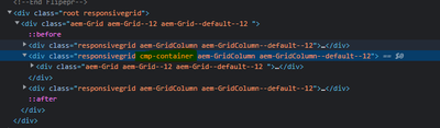

I'm trying to add this css class to the core component "Layout container"
And in author mode the class appears in the DOM
The css class has been added to the project's global css file
In dev and stage environments it is working correctly

my policy was replicated and it still doesn't work.
my policy path is as follows: /conf/my-prject/settings/wcm/policies/wcm/foundation/components/responsivegrid/policy_7061548212825753
will this be the problem?
