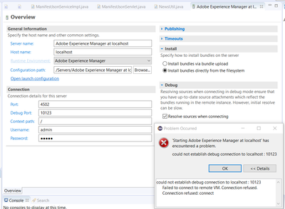

When attempting to debug I get the following error:
could not establish debug connection to localhost : 10123
Failed to connect to remote VM. Connection refused.
Connection refused: connect
I use the following command to start the instance:  java -Xms2048m -Xmx2024m -agentlib:jdwp=transport=dt_socket,address=10123,server=y,suspend=n -jar aem-author-p4502.jar
My debug port is 10123 and I have "resolve sources when connecting"  unchecked.

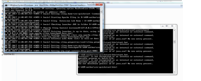

Once saved open the command prompt, go to \crx-quickstart\bin and type “start.bat”, once it’s done you’ll see another window of cmd being opened and the server will start in debug mode as seen below

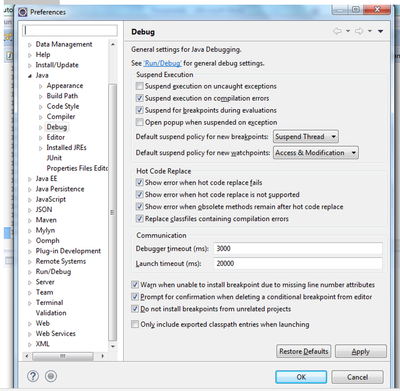

Eclipse by default will suspend execution on uncaught exceptions which will debug the code which we haven’t even selected. This will waste our time. So please do this to avoid it
Go to Windows - > Preferences -> Java -> Debug and uncheck “Suspend execution on uncaught exceptions”

I followed the above recommendations, and still I'm getting an error trying to connect.
My start.bat has the lines:
if not defined CQ_JVM_OPTS set CQ_JVM_OPTS=-Xmx4096m -XX:MaxPermSize=256M -Djava.awt.headless=true -Xrunjdwp:transport=dt_socket,server=y,suspend=n,address=10123
and
set CQ_RUNMODE=%CQ_RUNMODE%,crx3,crx3tar,debug
After starting the server, when I click on the debug option I get the following error.

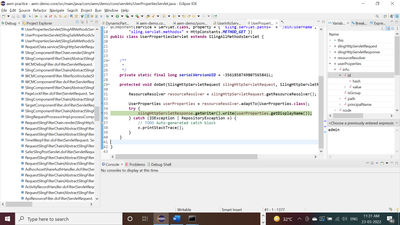

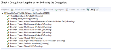

Here you could see I am able to debug -
