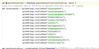

All the bundles are in the active stage, and the data is being retrieved correctly. The issue occurs specifically when we try to populate the data. The snippet below is the part that’s causing the error due to guideBridge. I’m attaching the code for reference.
