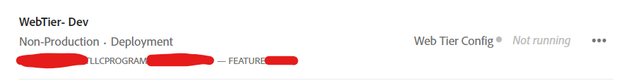

check your pipeline if webconfig is unchecked? There is a dedicated pipeline for dispatcher config, try with that maybe.
https://experienceleague.adobe.com/docs/experience-manager-cloud-service/content/implementing/using-...
AEM LinksLinkedIn
We already have a dedicated pipeline for dispatcher config as recommended.
