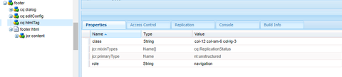

I'm using cq:htmlTag in my component as per below screenshot to add up the class and role to my <div>.

Component structure and cq:htmlTag
