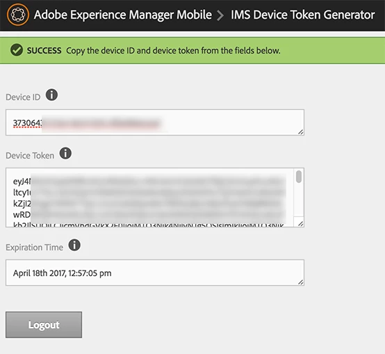

First, I'm able to use my ClientID on https://aex.aemmobile.adobe.com and obtain my Device ID and Device Token.

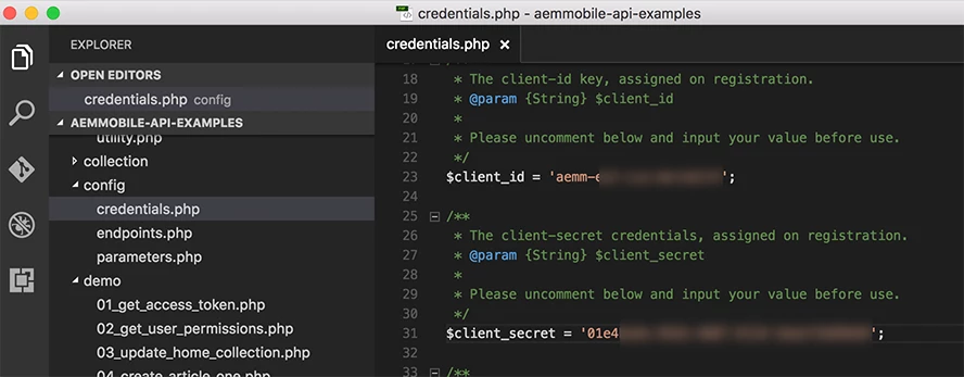

Next, I plug those values combined with the returned AEM Mobile On-Demand services form from Adobe in the configure.php:
After which, I can successfully run the demos - I can get my access token, create articles, assemble and upload articles, add to collections, etc... Seemingly things are working perfectly.

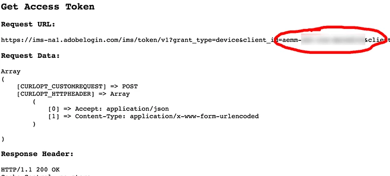

When I look the output from the PHP script, things seem in order:
However, when I debug that network call through a proxy, I'm seeing different values (X's below are hiding values)
device_idAEBE7800FAXXXXXXXXXXD36080XXXXXXXXXX87A038F41C292080XXXXXXXXXXC8
client_idProjectCentral12
client_secret814506d8-XXXX-XXXX-XXXX-XXXXXXXXXXXX
First, the client ID doesn't match - I'm not even sure where this "ProjectCentral12" is coming from.
Next, the device ID's UUID is in a different form.
Finally, the client secret does not match my UUID.
What's confusing about this, is that when I curl to test the API using my assigned values, I get http status 400, bad request.
However, when I use these values from above, the API call works.

Hi Jason,
Can you modify the scope to AdobeID,openid ? It doesn't appear to be right and that's why you get a 400 Bad Request (invalid scope)
POST call for authentication :
https://ims-na1.adobelogin.com/ims/token/v1?grant_type=device&client_id=your_client_id&client_secret=your_secret&scope=AdobeID,openid&device_id=your_device_generated&device_token=your_token_generated
client_id + client_secret => API key that you have received from Adobe;
device_id + device_token => these values generated with the AEX tool
Andrei

Andrei,
Reducing the scope to AdobeID,openid appears to resolve the issue.
Thanks for the insight.
