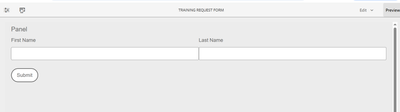

It is a simple form with one form fragment containing two input fields.
