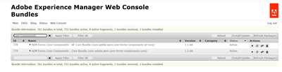

There is only one version of AF Core Components 1.1.66 in my local.
I tried upgrading to version 1.1.72 but it was causing issue with dependencies resolution and bundle was not active.
