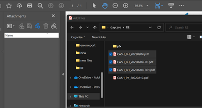

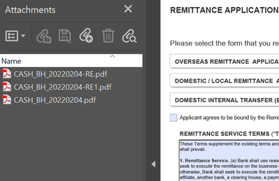

Click on Add atachment button in Acorbat DC and select multiple files
Are you trying to achieve this in an Adaptive Forms or a PDF? If it is an AF, then yes, this is possible in 6.5.11 onwards. You can add multiple files to an AF in one go.
Also, you may achieve the same in a Reader Extended PDF in Adobe Reader DC, or else you must use Acrobat Pro to achieve the same. Thanks!
Oh my gosh how did I miss this? Thank you for the guidance. Sorry for the trouble.
