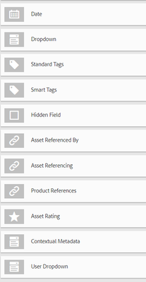

We had a similar issue with "Asset Owner" field, which was mandatory and should have populated all users list. But due to the limit, it was always incorrect/ didn't load fully. We had to change it to Standard tags field, instead of dropdown as a workaround. You might want to try that from metadata schema editor.
