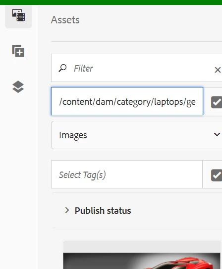

Hi @vani1012
Please use sling:Folder as primary-type & sling:resourceType while creating asset folder.
Nitin_laad
January 20, 2023
Can you please clarify the type of images that are being used here? Are they of the same type or different types? Additionally, could you check if the images are in a locked state, which may be causing the issue and preventing them from showing up?
Vani1012Author
Level 6
January 23, 2023
Both image types are same and its jpg and they are not in locked state.
I replicated the issue on local there I can see the logo but in test environment I am not able to see
digarg17Adobe EmployeeAccepted solution
January 23, 2023
@vani1012  : can you just try and search for the other image which is missing by its name - is it showing up?You can try to run Dam update workflow on it and try again. Is it in a processed state , can you try and upload it again ?
