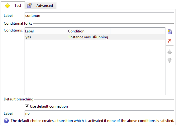

Hi Kanwaljit,
The solution here could be to use a concurrency check for the workflow instance by using an instance variable called isRunning.
Instance variables are shared by all the parallel executions of the workflows.

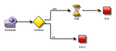

Here is a simple test workflow:
The scheduler is triggering an event every minute. The next test activity is going to test the isRunning instance variable to decide
whether or not to continue the execution:
Note: isRunning is the variable name I've chosen for this example. This is not a built-in variable.
Then the activity immediately following the test in the yes branch must set the instance variable in its Initialization script:
instance.vars.isRunning = true
Finally the very last activity in the yes branch must revert the variable to false in its Initialization script:
instance.vars.isRunning = false

Hi Kanwaljit,
Adhiyan
Test workflow :
Set up the instance variable:

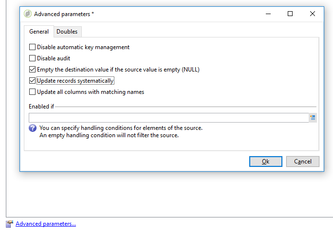

Hi Kanwaljit,
In Adobe campaign there is no configuration available to enforce locks, you can use SQL activity to use SQL code to use locking if required.
Now you have two option, either change the workflow design to prevent this from happening or you can use below approach, which will cover some use cases with obvious performance tradeoffs.
1. Reduce batch size i.e to 100
2. Use Update records systematically
this should be able to fix your issue but redesigning the workflow should be the ideal solution.
I have implemented your suggested solution into one workflow. However I get problems as soon as the workflow gets paused due to an error. In such scenarios the isRunning variable is still set to true even after restart. Is there any way to auto-reset the instance variables in a workflow when the restart-button is clicked?
Solved by setting the isRunning-variable to false in the advanced tab in the scheduler-activity. This is code is only triggered upon restart/start and not by "execute pending tasks now"
