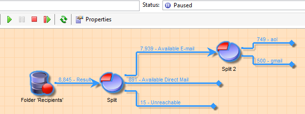

Here is an example workflow I created, which after execution goes into the Paused state:
On the second Split activity I am selecting to "Enable but do not execute" and restart the workflow. I see it doesn'r execute further and it goes into the Paused state.
Then I change to "Do not enable" for the Split 2 activity and restart the workflow. I see the same.
How are those two options different? Can you give me an example/screenshot from the practice?
In which case the workflow would skip the activity and execute till finished state?
Pavlina
Hi pavlinao80321508​,
Referring to the first screenshot, when you execute the workflow and it goes into a Paused state because your workflow is not configured to end. To move the workflow to a Finished state you need to have an End activity connected to the two transitions.

Hello Vipul,
in this case which option would cause to skip the activity and execute the workflow till finished state?
Do not enable or Enable but do not execute?
Pavlina
Hi Pavlina,
There is no way to skip an activity in a workflow. If you don't want to execute an activity but execute the remaining workflow, you will have to delete the activity from the workflow or disconnect it from the workflow transition and select Do not enable.
