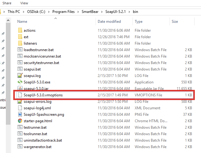

  • Go to bin folder inside installation folder of SOAPUI. For me it was C:\Program Files\SmartBear\SoapUI-5.2.1\bin. If you have installed the 32bit version of the software, please check for it under Program Files(x86) folder.
  • There should be a file named SoapUI-5.3.0.vmoptions. It might be different if the version of SOAP UI is different but the name should have vmoptions.
  • Add the following line inside this file and save it. It might ask you to login as administrator before making this change.
    -Djsse.enableSNIExtension=false
  • Once done, close SOAPUI and re-open it. Try firing a soap call and hopefully handshake error should not come. This helped resolve issue from my machine.
