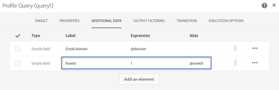

First, set the profile query (add an additional column with a value set to 1)
