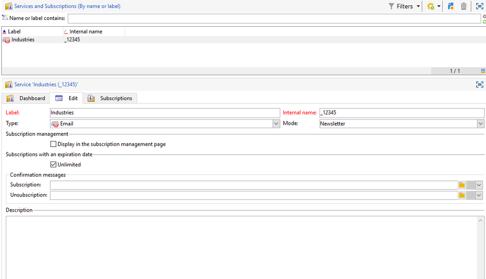

I have a requirement to add a custom field with a textbox in the below Service and subscription UI.
I tried to add a field in the OOTB-input form "Service subscription wizard" in path : /Administration/Configuration/Input forms/.
But couldn't possibly do it.
Just wanted to know whether it s it feasible to add a new field to this UI or can we extend this UI?

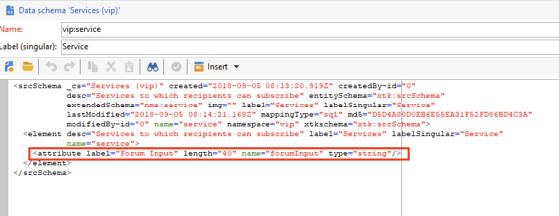

Extend the schema nms:service with the field of choice

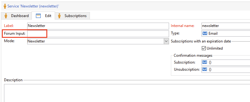

go to input form nms:service and make the modification at a location of choice. I've added it here
The form looks like this
Vipul
Vipul
Thanks Vipul it worked
