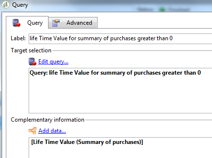

For this purpose, in the query activity I have my Targeting and Filtering Dimensions set to Recipients and filtered for those whose LTV is greater than 0.
I want to add the actual LTV to the temporary table so that I can make my split based on the value.

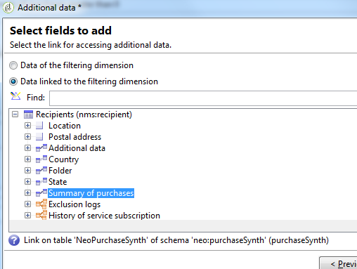

So, I click on Add data..., then Data linked to the filtering dimension.
Question:
Is there any difference in those two approaches?
1) Select "Data of the filtering dimension", then from the linked table Summary of purchases - Life Time Value
OR
2) Select "Data linked the filtering dimension", I see the linked table Summary of Purchases
According to my testing, no difference in the two approaches. Perhaps the first one is slightly faster to set up. Am I right?

Hi Pavlina,
Since the two tables have a 1:1 linking between them, you should opt for the first method which is to pick Data of the filtering dimension.
This will create a JOIN query between two tables and hence will perform faster.
Second method should be used when you are planning to query on 1:N link.
Hope this helps.
