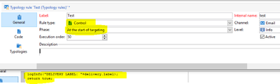

I have tried the same code at my end and I can see the label of the delivery is getting logged in Delivery Audit.
I believe you are using Rule Type as Control, so I created same with following configuration:
Can you check this?

Thanks for the response @SriBhargav_94 , however, I do not see this one in my delivery audit tab. Moreover, in your log, I can see the line where it says "Applying rule test", I do not see this happening in my case as well. I did restart the windows service as well as the "nlserver restart mta" as well, bit nothing seems to be working here. Any suggestion is very much appreciated!!

Have you checked whether your rule is ACTIVE (if rule is not active, it won't be applied during analysis) and the Typology where your rule is mapped is same as what is configured within your delivery ?
