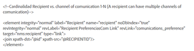

Here is the schema's "comunications_preference" XML:
<srcSchema _cs="comunications_preference (abc)" created="xxx"
createdBy-id="0" desc="xxx"
entitySchema="xtk:srcSchema" img="xtk:schema.png" label="comunications_preference"
lastModified="xxx" mappingType="sql" md5="xxxx"
modifiedBy-id="0" name="comunications_preference" namespace="abc"
xtkschema="xtk:srcSchema">
<createdBy _cs="xxx"/>
<modifiedBy _cs="xxx"/>
<element autopk="true" label="comunications_preference" name="comunications_preference">
<attribute label="codinternocomputacional" name="codinternocomputacional" type="string"/>
<attribute label="channel of comunication id" name="channel_of_comunication_id"
type="string"/>
<!--Cardinalidad Recipient vs. channel of comunication 1-N (A recipient can have multiple channels of comunication)-->
<element integrity="normal" label="Recipient" name="recipient" noDbIndex="true"
revIntegrity="normal" revLabel="Recipient PreferenciasCom Link" revLink="comunications_preference"
target="nms:recipient" type="link">
<join xpath-dst="@id" xpath-src="@RECIPIENTID"/>
</element>
<!--Indices -->
<dbindex name="codinternocomputacional">
<keyfield xpath="@codinternocomputacional"/>
</dbindex>
<dbindex name="channel_of_comunication_id">
<keyfield xpath="@channel_of_comunication_id"/>
</dbindex>
</element>
</srcSchema>

Hi @god_prophet ,
The Column which is used as Joining Key in the Enrichment (The field "recipients" and "comunications_preference" share is: "codinternocomputacional") differs from the joining keys being used in the Link (<join xpath-dst="@id" xpath-src="@RECIPIENTID"/>).
Could you Please check by adding the right Joining keys, Also , as we know that the Recipient ID is the Unique Joining key in Recipients Schema, please make sure @RECIPIENTID in the other schema is also unique for your requirement to work.
</element>
Also reg the Index ,in the above mentioned Link if you are searching based on the column (@RECIPIENTID) in your Workflows while sending deliveries or in any of the activities, then you can remove  noDbIndex="true" in the Link.
Pravallika.
