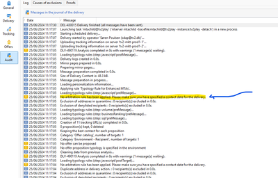

We are aiming at configuring a simple pressure rule for marketing emails. I want to use the build in functionality for this, however, it seems that it is a requirement that you specify a contact date on the delivery itself. That kind of does not comply with our way of working.
We always configure workflows with schedules to execute a delivery from a template. That means that the workflow will determine when the delivery is being sent, thus leaving "contact date" in the delivery itself empty.
Any idea how we can overcome this? Is there anything I am missing?
Thanks in advance for any help!

That is not feasible. My issue is that it requires a contact date on the specific deliveries. That does not really comply with our way of sending emails. We are executing emails from a workflow referring delivery templates. Therefore we do not have a contact date set on the deliveries.
