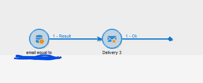

We always configure workflows with schedules to execute a delivery from a template. That means that the workflow will determine when the delivery is being sent, thus leaving "contact date" in the delivery itself empty.

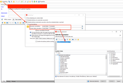

@SorenDP you can go to your Recurring Delivery activity and then inside Scheduling set a dynamic Extraction Date and a dynamic Contact Date
This will help set dynamic Contact date for every child delivery and will also apply pressure rule.
