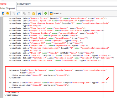

I have inserted some data in the extended recipient schema with the help of workflow. But while opening the navigation hierarchy of extended schema I am getting some errors. I am stuck on that point, can you please help me out. I am attaching the screenshot here. Please look through it.

Hi @Sukrity_Wadhwa   @Denis_Bozonnet   I am still stuck on this point and unable to resolve the error. I think there is some problem with joins with the recipient schema
I have made a 1:N join in ctc:recipient(extended schema) and ctc:tourHistory schema and defined this in tourHistory schema.
Can you please check once if my way of creating a join is correct or not?

Hi @Mrityunjay
From the original error, did you check the folder ids as previously mentioned earlier, do their folder Ids exist?
As for the relation, what type of cardinality do you want in tourHistory, could you check the nms:recipient data schema and find the tourHistory relation defined in the "Preview " tab? If you don't specify a reverse cardinality in the recipient link, you might not have the right cardinality in nms:recipient, same for tourReference... the links there should be external JOIN (unbound="true" should be indicated),
  1. So, check the folder IDs referenced in the error
  2. Check links in both Recipient and tourReference to tourHistory...
    1. tourHistory to Recipient: should be 0-1
    2. tourHistory to tourReference: should be 0-1
    3. Recipient to tourHistory: should be 0-N
    4. tourRefernece to tourHistory should be 0-N
