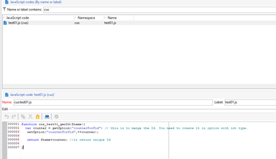

JavaScript Library: You need to create a .js file under JavaScript code folder in admin.
function cus_test01_genId(fname){

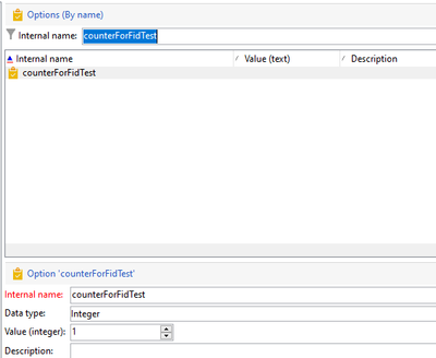

var counter = getOption("counterForFid") // this is to mange the Id. You need to create it in option with int type.
setOption("counterForFid",++counter);
return fname+counter; //it return unique Id
Option: To mange a unique fId, you need counter. If someone can enter same fName the it will keep fid unique.

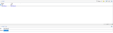

Final test: Enter Fname and save the value. Fid will be generated.
I hope it will help you.
