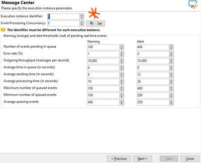

Hello @msnavin ,
did you press play on paused and failed workflow? You should restart it. There might be workflow variables that on paused state followed by restart will get undefined.
Is it not working every time?
If yes, have you assigned the instance? in Deployment wizard on execution instance?
And in external account on control instance?
