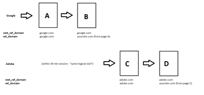

visit_ref_domain is the "last touch" referral domain for the visit. If someone had multiple referral domains within the same visit, I believe that the first set of pages that came from Domain A would say "A", and if the user left and re-entered the site within the same visit from Domain "B" all the pages in the second half of the visit would say "B".... in most cases, you will only have one... but there are people who have multiple tabs open that could hit the multi-referral scenario.
ref_domain I believe is the referring domain for each page... so let's say the user came from Domain A, the first page of the visit would say "A"... but now the user is in your site and visiting multiple pages... I believe that this would show your domain throughout the rest of the visit. Since they are going from a page on your domain to another page in your domain... you could in theory use this to see traffic from "inside your site" (something which is actually hidden in the Adobe Interface). This is in essence the "raw referring domain" for each and every page....
Both have valid use cases... but if you are trying to make an equivalency between what you see in Workspace and what you see in your raw data, I believe that the visit_ values are the ones to go with...
Here is a simple diagram to visualize:
And here is one showing the "multiple referrers in the same visit"
Gotcha and thank you for the diagram! Just to confirm I'm understanding correctly...
In most cases, the visit_ref_domain will always show you the domain of the "last touch" of the entire visit but the ref_domain will be the referring domain for each page.
