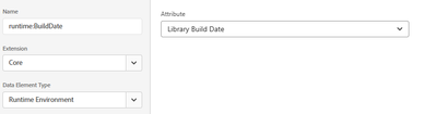

One thing that I did in my Launch setup was to set up some "runtime" Data Elements:
For example:
Then I configured a HIT based eVar (to make use of the longer character count) and set the runtime variables on every rule:
The full value for reference is
%runtime:PropertyId%|%runtime:BuildDate%|%runtime:RuleId%
This way I can see in my data what Property, BuildDate and Rule ID was used.
