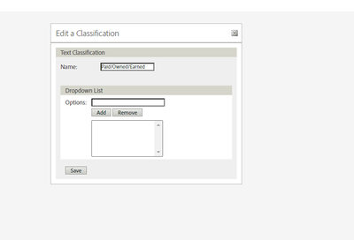

I am trying to edit an existing Marketing Channel classification, but when I click on edit I don't get any drop down list or can view the rule set. Does anyone know how to access an existing rule set for Marketing Channels?

You use two terms above, "Classification" and "Rule Set."  @VaniBhemarasetty  addressed editing the Marketing Channels.  If you're really trying to effect Classifications for your Marketing Channels, that will be something of a different nature. Are you bringing in data to your Marketing Channels that requires further breaking out via classifications, or are you simply just needing to send them through the Marketing Channel  Processing rules, as described below?
I an trying to edit an existing classification for Marketing Channel. I already have processing rules set up for Marketing Channel and the classification is based on those. But I think I may have  found the answer in using the classification importer function.
