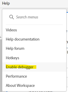

A little known fact is that Workspace is built using API 2.0; and you can actually get the API calls that are used right from the Workspace.
First, you need to enable debug mode:

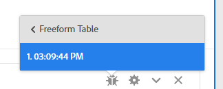

This will add a new Icon to your tables:
When you click on the icon, you will get the option for the Sparkline or the Table, choose the table:
Now, you will be presented with Timestamps.. more complex tables may use multiple API calls:
When you click on each time, a new page will open showing you the API used in multiple formats including JSON and Curl, etc.
This might be a better starting point than trying to write the API from scratch.
