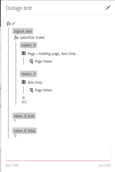

I was wondering if anybody knows if this is possible?
I am trying to build a metric that tracks the number of minutes that we have an outage on our website over any given time period. At the moment when the site is down  the visitor is presented with a holding page called "holding-page".
I have created the following metric that looks for if the "holding-page" is 50% of the total page views (for the site).
The problem is, when I look in a report broken down by the minute we can track this - however when I switch to a day breakout, the number returns to zero as Adobe is summing over the day. Essentially, the metric is working as expected but not as desired. I could calculate the data in SQL from our data feed but I want to keep this in Work space as it is more accessible to the business. Does anybody know a way to do this?

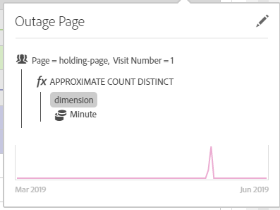

Quick update on this - The following returns the correct answer:
Please note that I have Visit Number = 1 as I noticed a caching issue where returning visitors were landing on the page which was artificially raising it.
Hope this helps someone.
