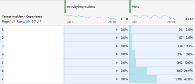

My team launched a new adobe target activity that happened from 4/11 - 4/17. I'm able to see the "Target Activity" and "Experience" show up in dashboards, and when I pull in the "Activity Impressions" metric I can see impressions during that time period.
However, when I use other metrics, that don't look to be built for the adobe target experiences, I'm seeing they are still showing up on days after the target activity was turned off (e.g. 4/18 and later).
Does anyone know why this is happening and a workaround? I'd like to include other metrics, in this example I have an "ID Count" which counts the distinct number of IDs.

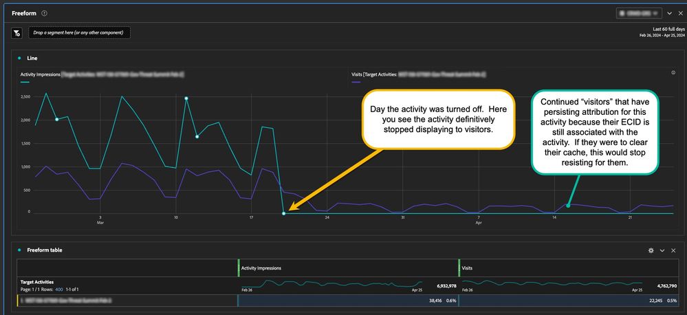

There are some metrics that persist because of the nature of "hit, visit, and visitor" based persistence.
"Target Activity Impressions" is a very hit based metric and will only endure as long as the activity is actually visually displaying to the visitor.
"Visit" and "Visitor" metrics will persist longer because this is based off the user ECID.  Think of it as the visitor is defined as an audience that qualified for this activity at one point in their past.
As long as they do not clear their cookies and the ECID that is associated with the activity still is applied to said visitor, they will continue to show attribution for that activity.
See the below image:

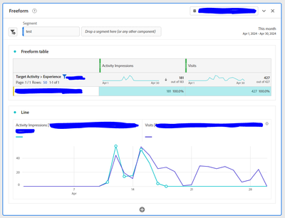

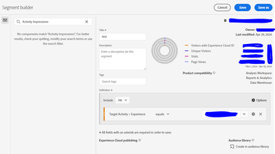

I've created the following segment. I didn't see an option to include the Activity Impression in the segment itself. When I search for it in the search bar, it doesn't come up as an option. So instead, I went the route of hit level segment where (Target Activity > Experience = Experience Tag)
I then applied it to the report I was looking at, at a panel level and I'm still seeing that the other metrics persist past the date the target experience was turned off.
