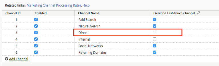

Could you ask the team to check the Override setting as shown below? - it should be unchecked.
And check that the Direct channel is at the end of the processing queue (an example below). If the Direct channel is on the top if may get credit instead of acquisition channels you are using.

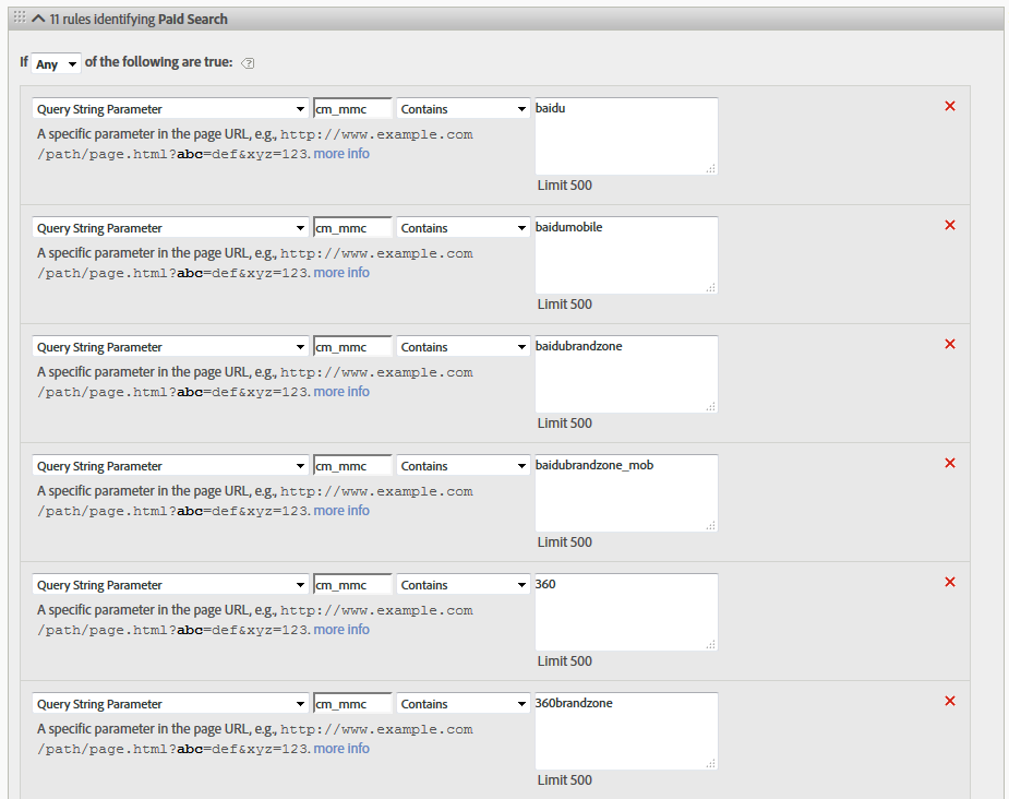

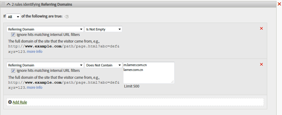

If you could provide a complete screenshot of your processing rules, that would be ideal (you can send it as a direct message).
Could you share a snapshot of the processing rules via DM?
We are affiliate brand site team, so we don't have DM access, but our global analysis team have the access.
The following screen shots are shared by  team.
This seems to be okay.
