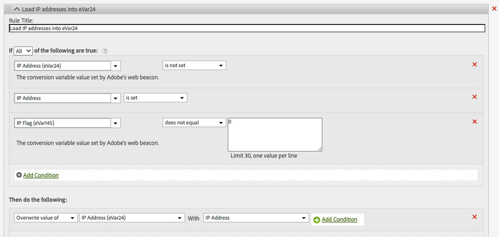

Sorry, I mean we want to populate eVarY only when eVarX != 0 (not equal).
To validate if condition position was the issue, we moved it last Friday to first section. But issue still there.
Please take a look to this screenshot:
 This is last Friday implementation:
I know, it's a small %. But we still think it shouldn't happen.
In your Rule, your first condition is that eVar24 is not set. So could it be that eVar24 is already being set in the implementation tracking code? In that case, since it has a value when the Rule runs, then the Rule gets ignored and AA dutifully reports that eVar24 value.

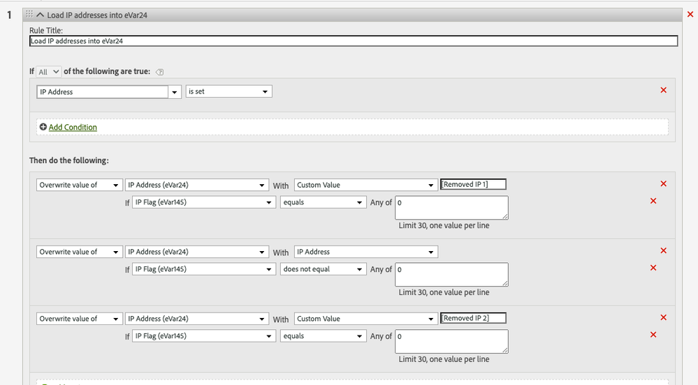

Hi @yuhuisg. In client side eVar24 is not assigned. But to be sure I did some changes to rule to remove explicitly eVar24 value when Flag=0. No result, issue still there.
Then I wonder whether the "0" is the culprit? From experience, sometimes AA doesn't "play nicely" with 0s.
Can you change your rule to make a test? Instead of "0", use another number, like "1". Then see if you still encounter the same problem.

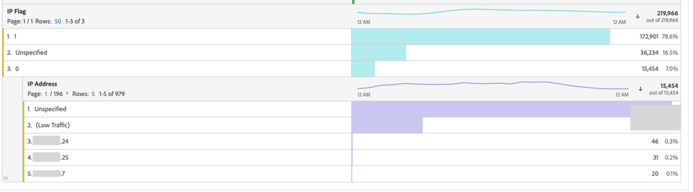

Yesterday, again I did a new testing. I'm sure something wrong with Rule. Look at this:
When you ran your report, was it for the duration after you had made your latest Processing Rule change (the new testing one)?
If it is, then I suspect the "0" could be the culprit.
Can you try switching your rule conditions to test for eVar145 = 1 instead? I.e.
Rule 1: If eVar24 is set, delete eVar24
Rule 2: If IP Address is set and eVar145 = 1, set eVar24 with the IP address.
In the above, Rule 1 ensures that eVar24 is absolutely blank before Rule 2 runs. In that way, you can be sure that eVar24 has a value only when Rule 2 succeeds.
