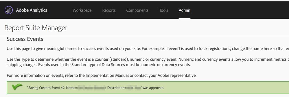

I defined a new tag in DTM named "registration" and associated it with event10, and went back into Analytics (Admin > Report Suites) and tried to create a custom event to match/sync this variable with DTM. However, it does not create a new custom event for me.
I see the following message (screenshot also included) but I never see the new custom variable in the list of variables below. What might be causing this erratic behavior?
"Saving Custom Event XX: Name=<myEventName>: Description=<myDescription>" was approved.

Just to clarify, in Analytics also I am trying to create event10 with the same name "registration"
From the screenshot, looks like you missed to changes status of event from "disabled" to "enabled"...Once enabled, if not earlier, after next login you should be able see your custom event within "Reports"...
Saurabh Kumar.
Hi Muzammil,
Can you please check the event status for the custom event and change it to "enable" if it is disabled ?

Thanks guys, for some reason I set it as counter (enabled) but it didn't save it. Tried again and it works.

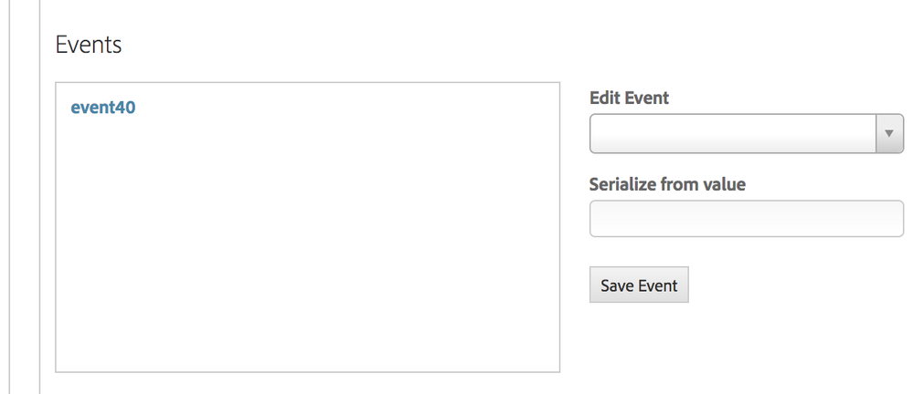

Could any of this be the reason?
1) I am currently embedding Staging library code on the site, and also have the report suite specified in DTM (screenshot below).
2) The rule was Active, but unapproved. I just approved it, waiting to see if that helps. Does it need to be approved in DTM in order to start showing up in Adobe Analytics?
I must also mention that the Web Property has x.mydomain.com as target URL specified in DTM. I am trying track this event on y.mydomain.com. As long as the domain is the same, will it target any subdomain?

With the screenshots you've provided, we can see that you only have a report suite specified for your staging environment. This means you'd need to load the staging library in order to send an actual analytics beacon.
Once we verify an Analytics beacon is being sent from the page with the correct report suite ID and events variable, we should see the data start to show up in reporting within 30-60 minutes.
This is the correct set-up for your non production environment to verify Adobe Analytics.
Rule just needs to be Active to test staging library code. Approve & publish combined is needed to move DTM rules to production library code.

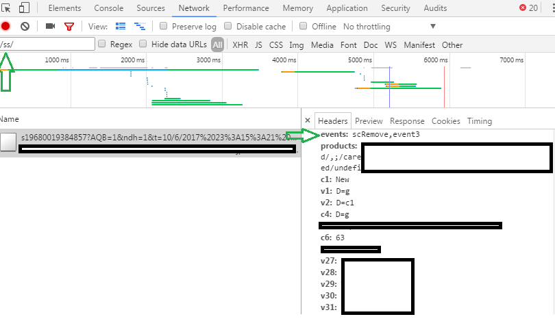

Looks like issue with DTM rule itself. Did you set-up event10 & choose s.tl() call within DTM rule set-up?
As suggested by Jantzen,  also check, within Developer tools, network tab & filter by "/ss/" to check if you are able to see any Adobe Analytics request when your rule fires. Reference screenshot below:

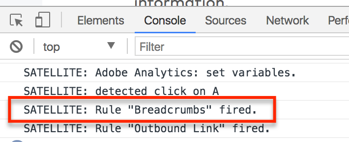

Yes, I do have s.tl() selected in DTM - and the event specified (event40 in this case, which is also created in Analytics and enabled).
Here's what the call looks like, I do see event40 and in the console it shows: SATELLITE: Rule "Breadcrumbs" fired.
What could be wrong?
Just updated my post, I am also seeing event40 in the network panel.
If do you have a screenshot of your image request in the debugger?
Adobe Debugger
Debugger only shows event9, no event40.
Chrome's Network Panel shows 3 calls, one of which shows event40 which I need.
If you are looking for the entire server URL/client info, I can private message you the non-blurred screenshots.
Yes, if your server is accessible outside your network, please send me a private message with the URL and steps to trigger the beacons.
As some general troubleshooting, If the beacons are being fired correctly, DTM is doing its job and there may be something within Analytics that needs to be changed. Once I get a chance to review the beacons, I can provide more direction.
