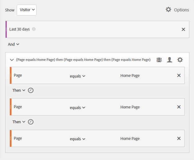

Here is an example for a visitor visiting the home page more than 2 times:
-Hyder
