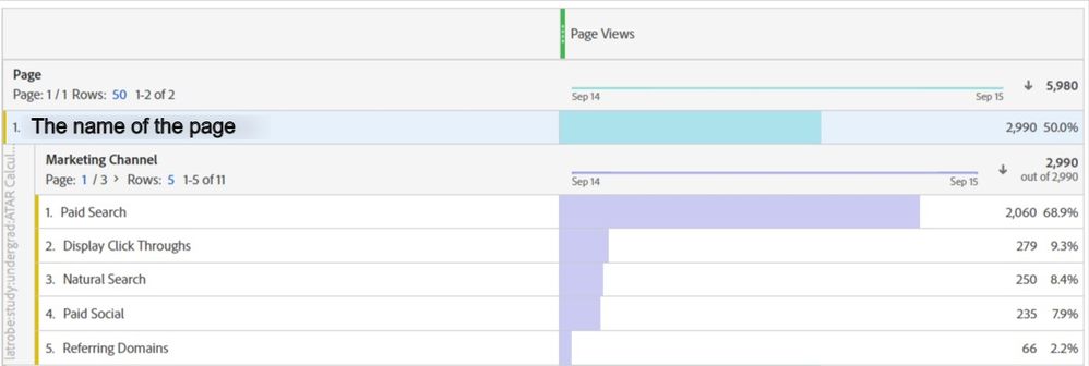

So the Custom Page View event is set to fire (from Adobe Launch) using a max-frequency condition of once per session. Yes, this might create an opportunity for the numbers to be wildly different, but you can see from the below images that they are fairly much identical (2839 for the custom event and 2990 for the regular pageview) - suggesting that in almost all cases people are only requesting the page once.
I am hoping these screenshots demonstrate the differences in attribution. Both panels refer to data collected between 14-15th September 2022. Referring domains is the dominant marketing channel for the custom event, however paid search is the dominant marketing channel for the pageview metric.

Firstly, referring to your screenshots, you can actually use one freeform table with the 2 metrics "Page Views" and "Custom Pageview Event Name" side-by-side. Then you don't need to have 2 tables, let alone have different dimension/metric configurations per table (which can make it complicated to compare them easily).
Furthermore, your first set of screenshots where, in the first one you compare Marketing Channels x your Custom Pageview Event, vs the second one where you compare a specific Page broken down by Marketing Channels x Page Views. So again, this isn't a fair apple-to-apple comparison.
Hey @yuhuisg - thanks for your reply. I really appreciate it. And thank you for the tip re: side-by-side comparison in a freeform table.
RE: "Furthermore, your first set of screenshots where, in the first one you compare Marketing Channels x your Custom Pageview Event, vs the second one where you compare a specific Page broken down by Marketing Channels x Page Views. So again, this isn't a fair apple-to-apple comparison."
I appreciate its not apples for apples. But what I don't understand is why it is so drastically different. Why (in one case) is traffic being chalked up to "Paid search" (expected) while in another case it's being chalked up to "Referring Domains" - when the visit count to this page is essentially the same (note that I haven't shown/provided data on that above)? Is there a technical reason for this?

Looping back with the solution to this original post.
It ultimately had to do with my marketing channel processing rules. The initial pageview had the campaign variable (cid string) passed along with that hit, which was then subject to the marketing channel processing rules - qualifying the hit as originating from Paid Search. However, for the custom event emulating a pageview that fired off at the same time, a campaign variable was not passed along with that hit, and was therefore not caught by the "Paid Search" processing rule... and ultimately ended up qualifying for the "Referring domains" rule.
In this case - the solution requires some modification to the processing rules (i.e. stricter / more explicit definitions) to support this use case.
