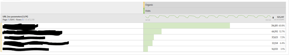

Hi when looking at my workspace with last touch channel as the dimension and visits as a metric, the total of the row items is not adding up to the total displayed in the workspace.
From my understanding only one last touch channel should be attributed to a visit (hence the name, last touch), but when looking at the report in this way I'm seeing a fairly large discrepancy when summing the row items (screenshot below).
Is adobe technically displaying here multiple last touch channels per visit? If so, what is the reasoning behind this? if i wanted to see multiple channels a user interacted with throughout a visit, I'd use a different dimension that isn't using last touch attribution.
Any help on this would be much appreciated !

hi thank you for the responses. but what about when looking at specific hits... lets say with last touch channel = organic and visits as the metric. Is this (below screenshot) specifically only looking at hits where organic was the last touch channel at the moment in time (in the hit the page was loaded) or the last touch channel just had to be set to organic at any point throughout the visit?
visit 1 - paid search-->page x --> organic-->page y
URL           Visits
page x          ??
would visits be incremented by 1 (above) since during the visit in which page x was viewed organic was at one point a last touch channel? or would it not show any values since it's looking at just when the hit happened for page x in which case the row item would not be incremented by 1 since paid search was the last touch channel at that point?
In the example you provided above, organic would be the last touch channel for page y (assuming you enable organic to override paid).  Its the last channel set prior to seeing page y.
If you use a 'hit level segment', the view of 'page y' would only be attributed to organic.
If you instead used a 'visit level segment' the view of both pages could be attributed to organic.

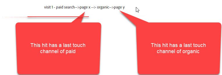

hi thank you for the responses.. but what about when looking at specific hits... like the example below when using a segment, visits metric and page dimension. id assume the page x visits would be zero since there was no hit with organic and page x?
     segment applied- hit level-last touch channel = organic
URL           Visits
page x          ??
