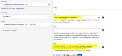

1. What I am doing is, setting the data element variable and then selecting the data object.
2. Then in the rule, I am setting the update variable action and mapping variable there.
3. Then I set the second action that sends the event, in that I am using event type "Web Webpagedetails Page Views" and setting data, I tried setting both xdm and data, only xdm and only data, but nothing is working.
Please help me find what I am setting wrong.

Also from your screenshot it seems like you are trying to send XDM object using data field which may through some errors during the send event call.
You can send your complete non-XDM data layer using data field and use data prep to map that to your schema.

Use the XDM field to send XDM object not the data field.(Point 4 screenshot)

I changed the suggested solution, Set the XDM field for the XDM object in the Send event.
Still do not see processed data.

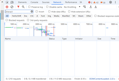

When you say "still do not see processed data", there are really no network requests in the debugger or in the network tab when filtering for "/ee" ?
Should look somewhat like this.
Also, what happens when you set neither XDM nor data object? Is that triggering any call?
Cheers from Switzerland!
No Network request in the network tab on the AEP debugger and in Inspection tool.
To Answer the following question.
Same thing I am seeing, I can see the library version of web SDK but no network request.

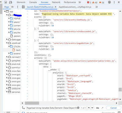

hi @kaur_amneet
Try checking if your changes are being updated in the launch script on your page.
  • check with _satellite._container on console and validate the environment and property are correct as on not.
  • go to sources tab check for assets.adobedtm.com > launch search with your rules names in the code and check if everything is updated or not.
If everything is fine try creating a new library in launch and adding all your changes again and try rebuilding it, this has worked for me in the past several times.
Thanks @Ankit_Chaudhary,
I checked and I am seeing launch file updated with the rule name.
Also checked on the console, and Build Property, and library are correct.
Also, Created a new build to publish my changes, still do not see the data _analytics object in the browser or in the AEP debugger.
