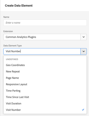

are you using Adobe Launch? If so, you do not need to copy the plugin code, but can use "Common Analytics Plugins" extension. This will make sure to always keep the plugin versions up to date (as long as you keep the extension up to date).
Note: You must initialize the right plugin in a rule that loads as soon as the library is loaded
After that, you will be able to get the visit number through the data element
Hope that helps
Cheers from Switzerland!

What keeps you from using the extension 😉
It will be a no-code solution

I would definitely go for the extension and included data element type, then there is no discussion 😂
Yeah, and if you aren't a coder, this will make things a lot simpler 🙂

What keeps you from using the extension with the plugin? It also has a bunch of other useful extensions that might be interesting for you. No need for copy+pasting code.
i would at least give it a try. That way, you can also keep the s object hidden

Also, I agree with Bjorn... using the extension would be a lot easier.... is there a reason you are avoiding that?
Thanks All for your suggestions.
we will impliment this changes through extension only.
