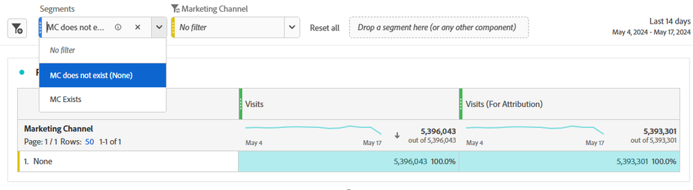

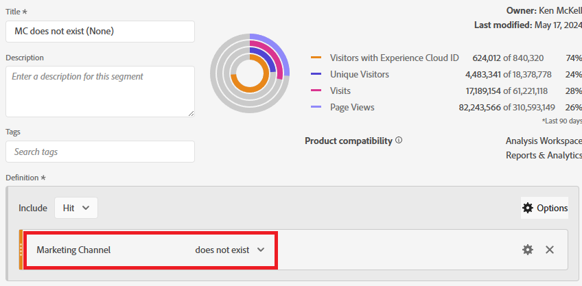

Somebody else here at Adobe (above my paygrade) will have to figure out why the "None" value in the filter produces nothing.  In the meantime, you can create a separate dropdown with two other segments to get what you're looking at.  Not ideal, I know, but it's the only thing I can think of.   See the attached screenshots.
Segment #1:
Segment #2:
Using the second dropdown:

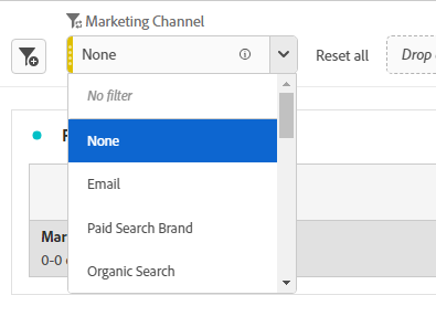

HI @JayGr
can you post a screenshot of the filter overlay please? Any other value like "Email" shows data?

My original question (though I assume related) centered more around the filters:

That's what I'm saying. That doesn't work. It gives me nothing and not None.
Segment #1:
Segment #2:
