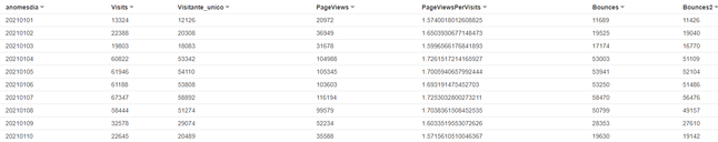

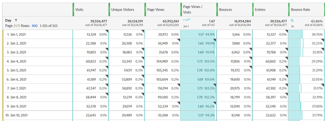

I included a preview of my data, comparing the data from Workspace Analytics or Report Builder and the script from Data Feed:
Workspace Analytics or Report Builder:
Data Feed:
The visits, unique visitors, page views and page views / visits are ok (I followed the rules of the calculate metrics documentation: https://experienceleague.adobe.com.mcas.ms/docs/analytics/export/analytics-data-feed/data-feed-conte...), but the number and % of bounces are different.
The field “Bounces” I use this logic: count only the records with visit_page_num = '1' (the same that you said to me).
The field “Bounces2” I use this logic: count only the records with visit_page_num = '1' and post_page_event = '0'.
But both fields are very different from the Workspace Analytics. I don´t know If I have to include one more condition in my script to receive the correct data.

I did a case condition for both columns (column Bounces: case when visit_page_num = '1' then 1 else 0 end and column Bounces2: case when visit_page_num = '1' and post_page_event = '0' then 1 else 0 end) and in the end I sum each columns values.
But I have to keep the distinct record based in what column or what rule?
Yes, for visit when i group the values i use this rule:
  1. Concatenate post_visid_high, post_visid_low, visit_num, and visit_start_time_gmt.
  2. Count the unique number of values.
This time, I chose one day (“2021-01-01”):
Workspace/Report Builder: 5.166
Data Feed: I selected all the records from the day “2021-01-01” (28.129), I concatenated the columns “post_visid_high || post_visid_low || visit_num || visit_start_time_gmt” and, after the concatenated, I identified how many distinct records appears only one time and how many are in the “visit_page_num” = 1, but the numbers are different again (6.376).
Do you have a practical example with the Bounce calculate? With the example I can see where are my mistakes.

I tried with this another condition, but the number only decreased 21 records (6.355):
I selected all the records from the day “2021-01-01” (28.129), I concatenated the columns “post_visid_high || post_visid_low || visit_num || visit_start_time_gmt” and, after the concatenated, I identified how many distinct records appears only one time and how many are in the “visit_page_num” = 1 (6.376) and how many are in the post_page_event = '0' (6.355).
I´m doing this analyze in Microsoft Excel, using pivot table and excluding duplicate values in the end.
