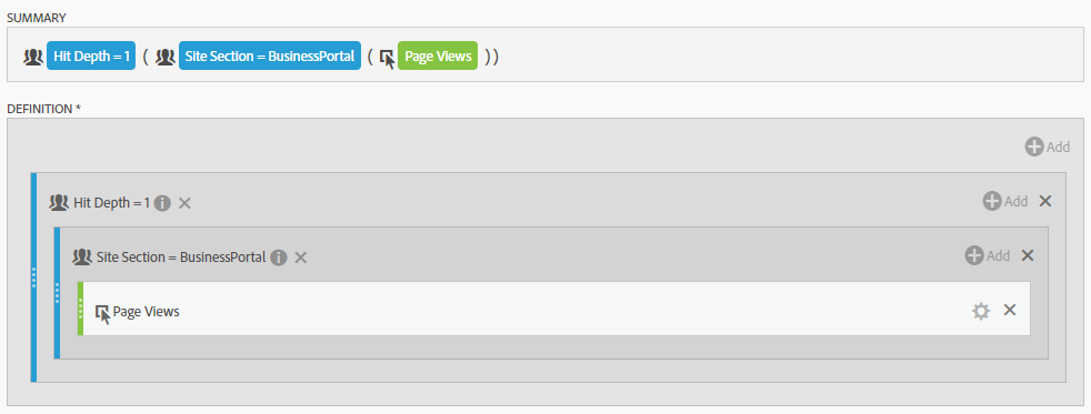

Dear Sai,
You need to use 'Hit Depth'. Check out Hit Depth!
Something like below will help to solve the query.
Thank You!
Arun

Hello Arun,
Thank you for you response.
I think your solution gives the hits where site section = BusinessPortal, only when the hit is the first hit in the visit (hit depth=1).
Here's what i am looking for, Consider this sample visit with hits in the order -
1: pageview with site section 'A'
2: pageview with site section 'B'
3: pageview with site section 'C'
4: custom link 'X'
5. pageview with site section 'D'
6. pageview with site section 'C'
7. custom link 'Y'
End of visit
Form this visit, i want the hit which had the first occurrence for site section 'C'. So in this case, that would be hit#3..
Is there a way i can create a hit level segment that gives me only such hits..  (first occurrence of a particular traffic dimension value)
this is what i meant from my question: "i.e within each visit, many hits can have site section equal to "xyz", but i only want the first hit that had site section = "xyz"."
